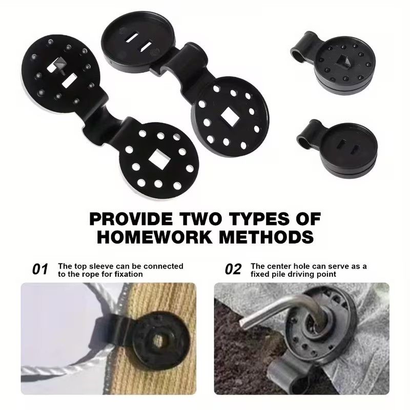

                </div><p></p>
<p dir="auto"><a href="https://www.temu.com/goods.html?_bg_fs=1&amp;goods_id=601102629233625&amp;parent_order_sn=PO-097-21151711537272532&amp;_oak_order_sn=097-21151782316152532&amp;_oak_goods_num=1&amp;sku_id=17605626152134&amp;_x_sessn_id=j40duwnzzw&amp;refer_page_name=bgt_order_detail&amp;refer_page_id=10045_1779049039365_0ipkrjxl0c&amp;refer_page_sn=10045" rel="nofollow ugc">https://www.temu.com/goods.html?_bg_fs=1&amp;goods_id=601102629233625&amp;parent_order_sn=PO-097-21151711537272532&amp;_oak_order_sn=097-21151782316152532&amp;_oak_goods_num=1&amp;sku_id=17605626152134&amp;_x_sessn_id=j40duwnzzw&amp;refer_page_name=bgt_order_detail&amp;refer_page_id=10045_1779049039365_0ipkrjxl0c&amp;refer_page_sn=10045</a><br />
הם יחסית מאוד קטנים, תמדוד עם סרגל, והם מתאימים רק לבד ברזנט מחורר, ולא לבד פיויסי</p>
